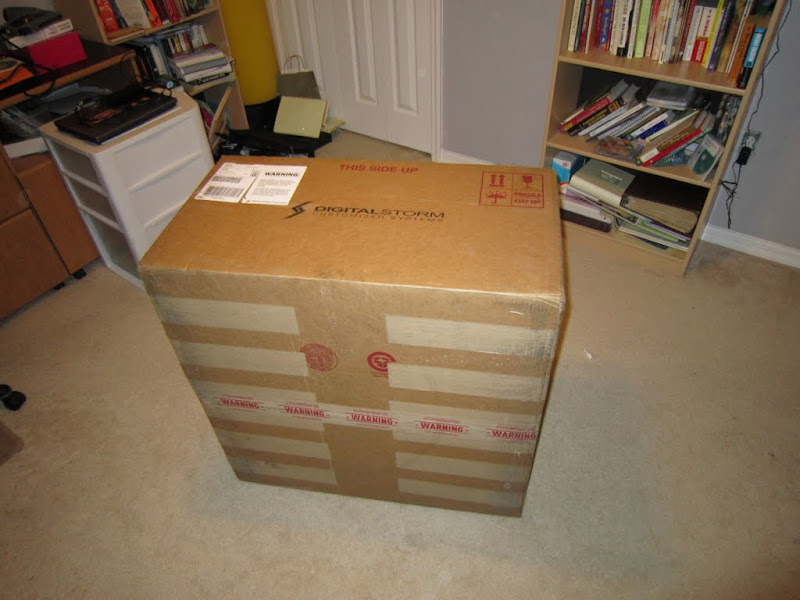

Hello there. I am review cat. Today my owner has tasked me with reviewing his shiny new Digital Storm Assassin.
So here I am testing it out.
and I'm done. I love it as much as he does. Awesome job DSO. I'm outta here.
Ok, so now that Review Cat is done, I can give you my take on it. Let's start with a score, a few words on what I think and then the pics.
All up, my entire experience with DSO is a 9.8/10. Absoloutly mind blowing. From their product selection, to me placing my order (and my sales guy not up selling me, in fact he SAVED me money) through the waiting process where they take such amazing care in building each system... all the way to the finished product. A system that is as beautiful as it is fast. A system tiers above what I could build myself, even if I could wade through all the information online and buy the parts that all work together.
Unboxing was a joy. No major issues at all. I would do my purchase a little different next time. For instance I wouldn't go with the fans/noise reduction addon. It just doesn't need it. This is the quietest thing in my computer room, infact now I can actually hear all the other tiny little distracting sounds. I probably wouldn't get the OC'd GPU.
The heatsink on this baby is amazing. It's the Noctura D14. Holy silent and cool batman. Temps are a cool 28-30c. (86f). Ambient in the room here is around 75-78. Thats pretty damn good. GPU is about 40c idle and about 65 in games. Not bad at all.
If i was to pick one small item that was a little below my expectations, it would have been the wiring on the backside of the case. I think it's also to do with the sound material. when i undid the case on the backside, it had quite a bit of tension on it and i could tell things were REALLY tight back there. Not a major issue and one I thnk I can solve myself.
only other issue I had was mounting my SSD. There wasnt a SSD type power connector easily usable near where the SSD mounts. Also the cables that come with the system don't allow you to mount the SSD there very well, but i think that is just an issue with this case paired with this mobo and me not getting a SSD from DSO. i know if I had sent it too them, it'd be mounted already and done right. Luckily I had a straight (no 90deg connected on the end) Sata cable, and a 4 pin to Sata power cable. All works great.
All in all I dont think in 35 years I have EVER been this excited to get something new nor have I been privy to this level of service and craftmanship. amazing experience. I will buy no other systems for as long as these high standards remain.
Ok, so enough talking I guess, on to the pictures.
